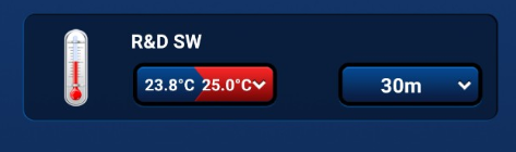

    I can see that now I have that room under Climate in the app, in there I can override the Heat Panel settings by entering another temperature setpoint and duration.
    Doing that turns on the manual mode, and I can see that in the web interface. Just after entering in the app it is shown like this :
    But when I leave that screen and return to it, I can no longer see that setting, it is as before :
    This is confusing, as it seems that manual mode is not active, while in the web interface it is shown as active :
