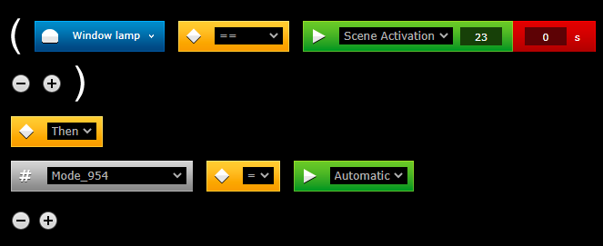

    The following scene captures that S2 goes from OFF to ON, which means that mode is set to "Manual" (954 is the device ID, hence my choice of variable name)
    /monthly_2021_01/Set_to_manual_mode.PNG.8e2189eac59ce957c4153f2b8910643a.PNG" />
    The following scene captures that S2 goes from ON to OFF, which means that mode is set to "Automatic"
    An example scene making use of the mode button.
    The lamp is switched on when evening falls, but only if mode is "Automatic"
    I am using this concept in our bedrooms, allowing  members of the family to easily choose if their window lamp should be controlled by the system or only by the wall switch. It eliminates the need for me to go in and change the programming as soon as they change their minds about how "automatic" their room should be. Now they can decide for themselves by flicking the switch.
