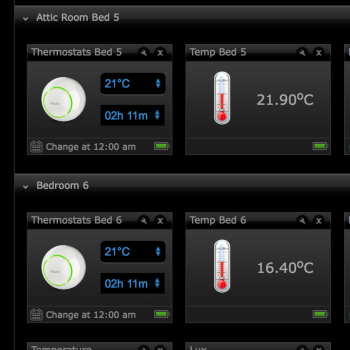

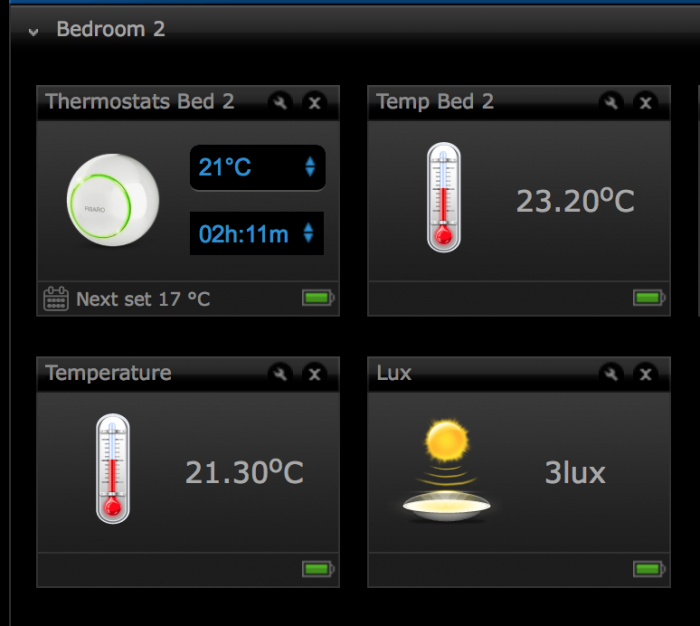

    See I'm not sure this is working with HC TRV's.
    I'll give you 2 examples in the image:
    So at the moment my gas boiler is on:
    Bedroom 5 radiator is hot - TRV set to 21c but sensors is 21.9
    Bedroom 6 radiator is stone cold - TRV set 21c but sensors is 16.9c
    Bedroom 2 radiator is stone cold - TRV set 21c but sensors (with offset of 3c) is 23.2c however from my motion sensor the room temp is 21.3c (not used for the TRV)
    It's normal, because the system knows 23 (>21)
