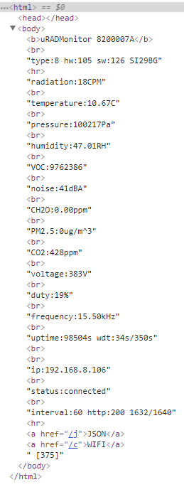

    I have found that I can type in an ip adress in my web browser and receive the following information:
    /monthly_2018_03/Skjermbilde1.PNG.fd182ddd5154b4905ce285c7a3efcf88.PNG" alt="Skjermbilde1.PNG.fd182ddd5154b4905ce285c7a3efcf88.PNG" />
    When I look on the html code for that page, it looks like:
    If I create a viritual device in HC2 and use the IP adress for the UradMonitor, is it possible to get these values into the Fibaro software with LUA code?
    By using 192.168.8.106/j, I get a json link:
    {"data":{ "id":"8200007A","type":"8","detector":"SI29BG","voltage":382,"cpm":14,"temperature":9.45,"humidity":48.29,"pressure":100281,"voc":12800000,"co2":399,"noise":39,"ch2o":0.00,"pm25":3,"uptime": 107787}}
    How can I convert this to values with lua code?
