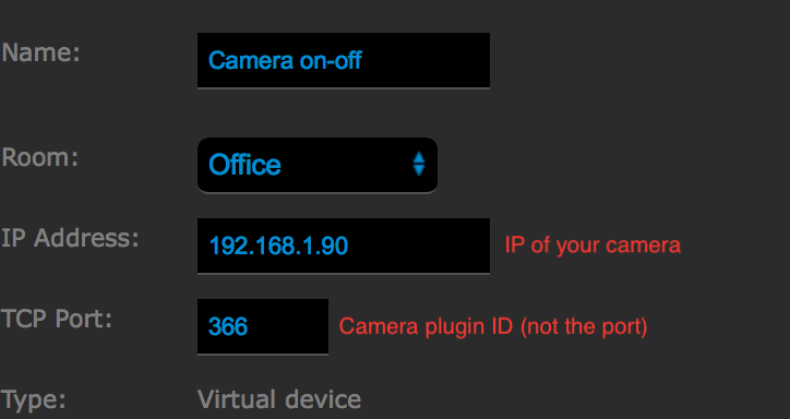

    Settings of VD: (No need to change LUA code in the VD, unless you want something specific that is)
    IP = IP of the camera you want to control
    PORT= ID of the camera plugin you want to control
    Attached is the VD.
