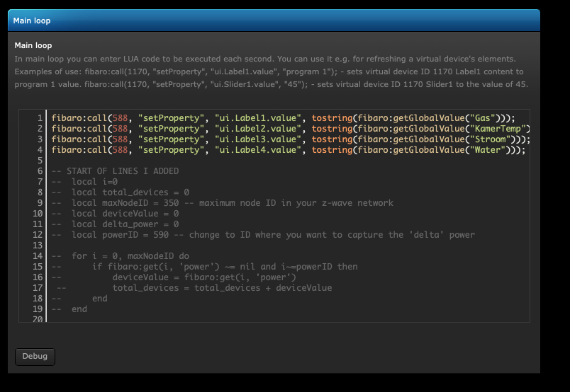

I use something similar. What I have done is the following. Basic idea is to use one of the z-wave modules which does not have an actual power usage measurement to store/report the difference between the total actual power (W) as reported by the p1/smartmeter and the total power usage as reported by the other zwave modules. This way fibaro will report the correct total kW/kWh, etc.
I have added some lines in your lua script to make this happen. I made edits line 45-63.
Hope this help. Rene.

  • Hi Rene,
    I tried your solution and it works like a charm. I now have all power usage visible in my main fibaro screen, as intended.
    Thanks again! ;D
    Regards, Erwin
    A few remarks for other readers: the device I sent the data to, obviously needs to have a power attribute, so a switch, dimmer, etc.
    Also, you need to disable the display of all the other power values in that power grid, or you will get double readings.

    On 5/27/2018 at 10:20 PM, ReneNL said:
    Hi @evanbeem,

    3 hours ago, ReneNL said:
    Yup, still working perfectly.
