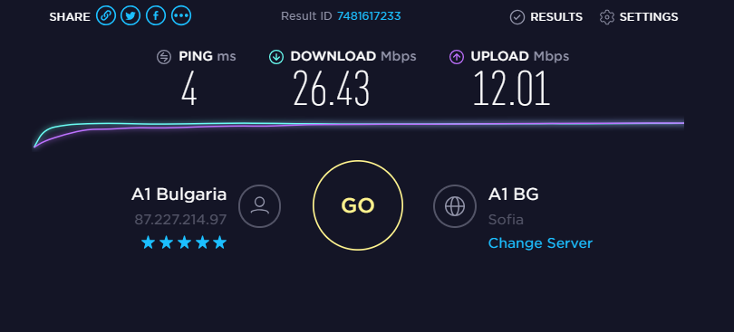

    I did couple of more tests but the observation is the same. Apparently there is some problem when powerline adapter has to send data through the FBWP and the plug is far away from the controller but I don't have explanation for that.
    Here are some screenshots to illustrate:
    1. Laptop connected via LAN cable to powerline adapter, directly connect to socket (normal behavior):
    /monthly_2018_07/laptop-to-EthPowerline.PNG.86b3c2fd37a6502ca8b2dce475a2a63c.PNG" alt="laptop-to-EthPowerline.PNG.86b3c2fd37a6502ca8b2dce475a2a63c.PNG" />
    2. Laptop connected via LAN cable to powerline adapter, connected to FBWP (problematic behavior):
    Strangely enough if I remove the FBWP from the HCL, the powerline adapter doesn't work.
    If I have the chance I'll test with other powerline adapter or other smart plug but currently I don't have possibility.
