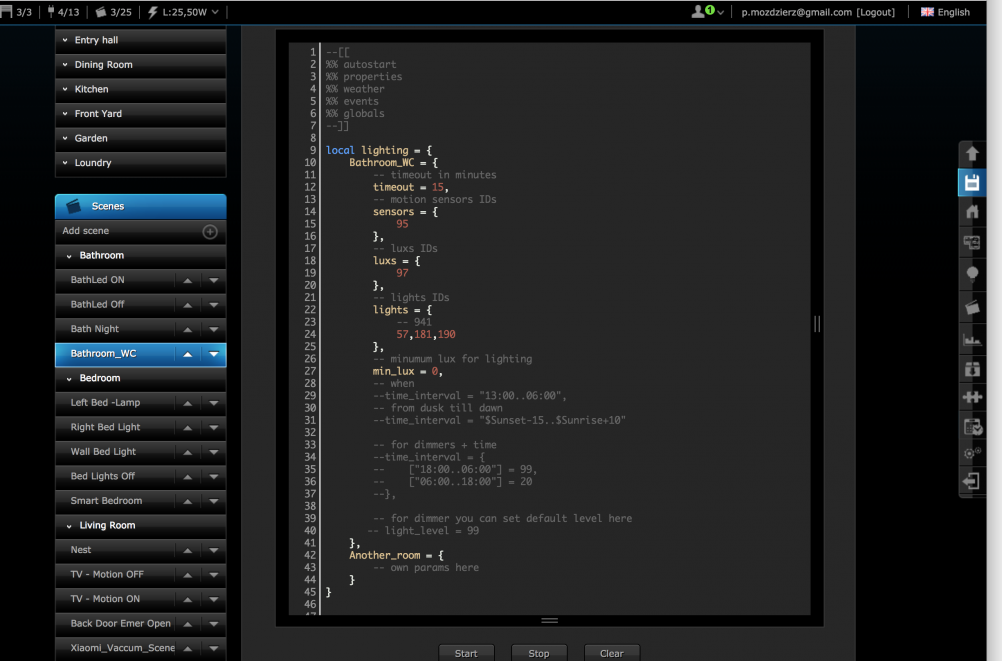

for example Please login or register to see this code.

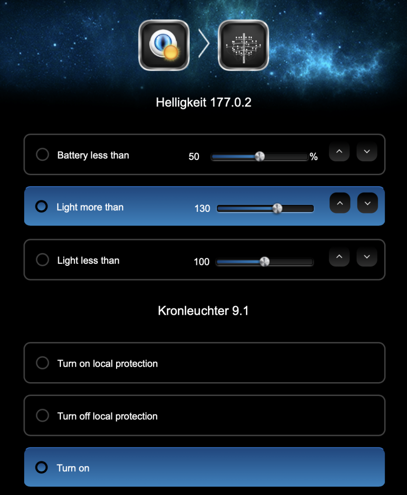

Hi, scene from @10der use a motion sensor and a switch, and turn on the switch when motion detected and turn off after time set, also use LUX value of motion sensor and turn on the light if LUX is bel
