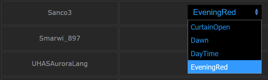

    Hi @Sankotronic, thank you very much!
    It is almost working, it will stay on "Ochtendgloren"
    I thought for you to better understand I will translate and I added one extra line to test if it is working.
    Regretfully  it is doing something it is changing between Dawn and DayTime, please can you look into it?
    Thanks in advance and sorry to bother you

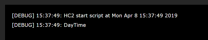

    Hi, see what you get as second line in debug.
    I've added some debug lines:
    /monthly_2019_04/image.png.f4953bb21ce27737238342c85f3256e2.png" />
    those values don't look right to me except sunrise & sunset
    Edited by Bodyart
    yep thats why he is changing GV what is not expected and I do not have a clue what is wrong.
    what did you add?
    This:
    the time behind the debug include the difference between the actions only the begin time is wrong?
    I think your definition of ochtendgloren should depend in sunrise and avondrood on sunset, doesn't it?
    yes it is
    is it???
    then why it shows such weird time?? see debug above 16:41 !

    the debug order is always starting with sunrise and sunset
    This scene is changing between daytime and dawn.
    First I thought if there is a typo or something wrong he will show the firts value in GV >>>false
    Why he skips "curtainOpen" is wierd
