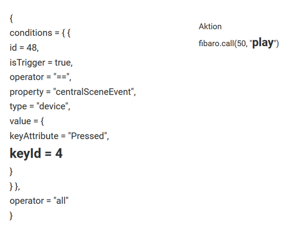

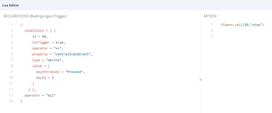

Hello everybody,
I climbed from HC 2 to HC 3. Actually I thought it would be possible to trace all the scenes. Unfortunately, Fibaro has adapted the LUA Editor. Since then I have tried unsuccessfully to put the IFTTT webhook trigger that I had set up for Sonso back on the Fibaro keyfob. Can anyone help me what exactly I have to enter for a LUA code on the "Action" page ????

It's possible to combine the conditions. I don't understand why they don't do it in the examples in the manual. Please login or register to see this code.
