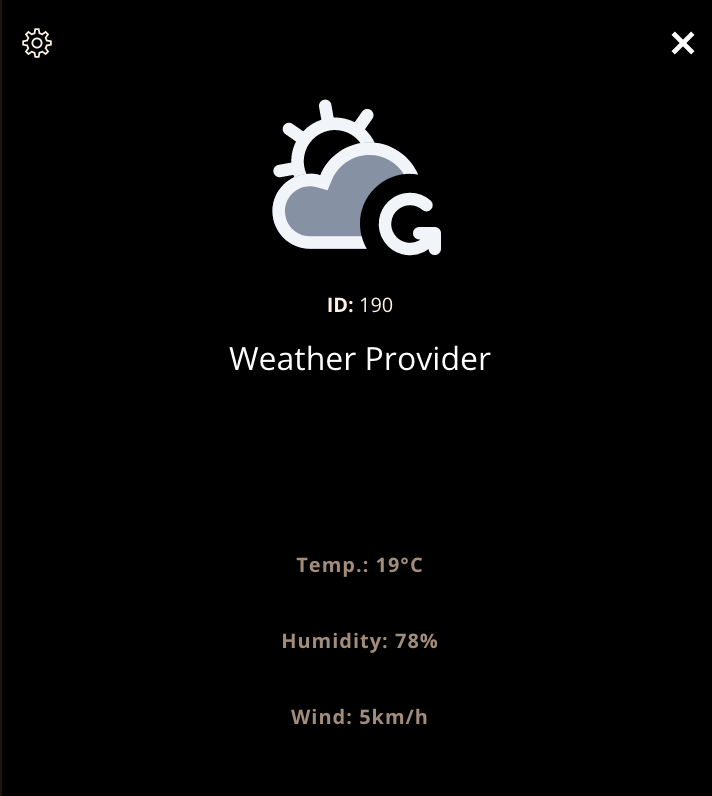

    My HC3 is on latest firmware 5.160.42 and first I installed provided plugin Weather provider and it does not update GUI weather:
    /monthly_2024_06/WeatherconditionGUI.png.724bc3efa86d1b1cd1d28464ee4df6d6.png" />
    here is what are measurements on Weather provider:

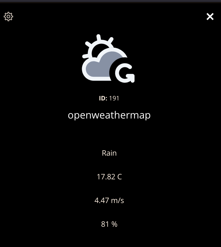

    Then I installed OpenWeatherMap provided on
    and still GUI weather is not updated. here is what openweathermap QA shows:
    BTW - above QA is actually useless, but I wanted to see if there is any LUA code that can be used to update GUI weather same as on mobile app. Of course Yubii Home app is completely missing weather, while Yubii app is showing wrong data same as GUI in the browser 🤪
