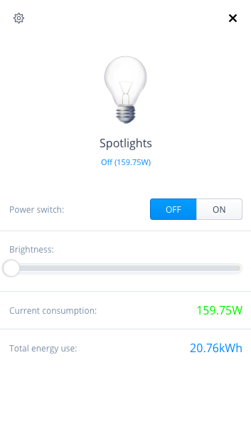

I have installed a bunch of ZV2835RAC dimmers (
) in my appartment, and while they work quite well, but I have one annoying issue I wonder if some expert could give some ideas on. The dimmer pairs well with Home Center 3, but it doesn't report its state correctly when pressing the physical knob. (on/off).
Controlling it through HC3 works great.
I managed to partly fix this, by adding another association group (2) for the device. (it only connects with one)
Now the dimmer does report back to HC when you click the knob.
That said, this dimmer knob also can be just "turned" to turn it on. When I do this, the dimmer does turn on, but it does not report in Home Center 3.
Basically this results in the dimmer showing as "off" in Home Center, but you can clearly see that it's on because the power reading is high :)
(see below)
Is this a hardware issue requiring a firmware upgrade? Is anyone else using Sunricher dimmers?
I got a lot of these, so I'd really like to try get them work 100%..
