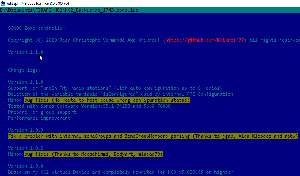

/monthly_2020_05/image.png.50fc69674d319c133e27c4419eb27e29.png" />image.png.82c6282a5a90a68abe25730a7faf65f7.png
I was thinking to store 2 files for each QA (and scene)
QA_<ID>.lua with the Lua code (maybe annotated with the fibaroapiHC3.lua intro/outro)
QA_<ID>.rsrc being the original json struct (but pretty printed to make it easier to eventually edit - like the layout)
Then a restore command deploy/restore command that combine them to a .fqa and upload them to the HC3.
Because we don't have a clean format we need some kind of resource fork. However, it's really nice with a flat file format that is easily edited.
Alternatively, we come up with some format that can be included in a comment in the code that describe the other properties like layout and quickvars and type etc.
Similar to what I attempted with
That makes three of us working on this ;) I think splitting Lua scenes in "conditions" and "code" like @10der did is the way to go, but the conditions are "json" and not lua (check extension)
Keep in mind though block scenes are JSON only ("actions" is array instead of Lua). Edit: If it's a block scene the conditions part is a json struct. If it's a lua scene it's a Lua table. At the moment I do not split scenes anymore.
I name my scenes based on ID and name, eg SC0042_BatteryCheck_v5.json but I've thought about using directories instead, because I think whatever we try to export on HC3 will end up as more than one file, but you might need all of those files to get back the original.
FQA's ... I export both the output of the device API and the FQA. There is a lot of overlap...
