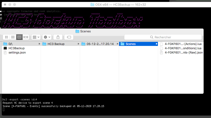

Tested on Mac mini under Sierra (10.13.6):
Scenes backup do the job
I plan to add an additional file ex: "4-FGKF 601 - Events- [Report] .txt" with basic but useful information: Name, Categories, start mode....
Edited by Krikroff
  • Thanks 2
