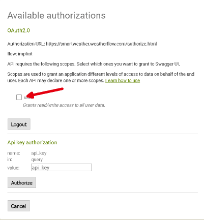

    It's easy :-D
    Just install the QA from @afendikov and fill in some variables, like your station number and api_key.
    To obtain the api key you go to:
    Then press the Authorize button and check the user.
    After that you go to stations and choose "GET stations". As a result you will see on the line CURL something like:
    where the Bearer value is your API key :-D

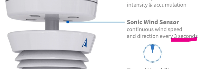

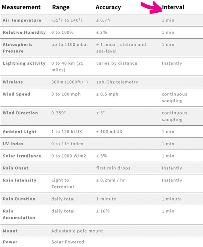

    Tempest, or "old" WeatherFlow station is sending data real time UDP, Websocket, or REST API :-D
    almost :) but that's sufficient for slats protection. I will definitely try it once available in EU Frequency range
    Edited by tinman
    Ok, editing: almost real time :-D I mean 1 minute looks to me good enough for HA.
