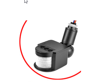

as I know Fibaro hasn`t any sensors with IP6x. maybe you can use under roof but nobody can garantee what water or show can reach your senosor under roof.
so. I do not know any zwave outdoor sensors here. sensors from AEOTEC can works as outdoor sensor but false-positive. and
/monthly_2020_09/image.png.339ba90919488bdcc15adf9b83bf9276.png" />
also this sensor can be uses
but as I know it's USA ZWAVE standard,
also you can use ANY outdoors powered motion-lights senosrs (non ZWAWE sure)
like
connected / wired with FIBARO UBS or FIBARO implant.
