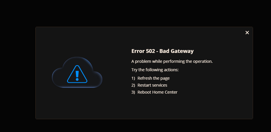

    Click on start scene 1:
    Click on start scene 2 or 3:
    HC doing something, but no result from scene 1, when checking history
    after 2min page refresh, no logs about execution of scene 1 called by scene 2 (or 3)

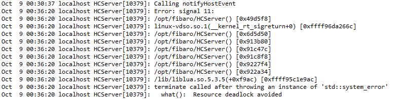

    note the "user modified", this is always sign of service got restarted ... and when i check the logs:
