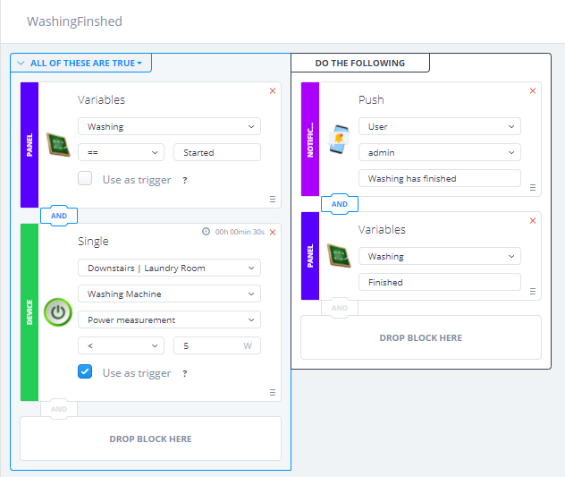

Did anyone handle the scene announcing that the washing machine was finished washing.
I remember that such solutions worked on hc2.
7 answers to this question
Sure, I do this with two simple block scenes:
/monthly_2020_11/image.png.52d58c7cc5d41830d1ea28bebf3118df.png" />

    Thanks. Very interesting, I will test.

    What are the variable (just Finished) or.
    Thanks in advanced.
    Never mind i found out the variable

    I wanted to make a similar scene, just tried this. Thanks!
