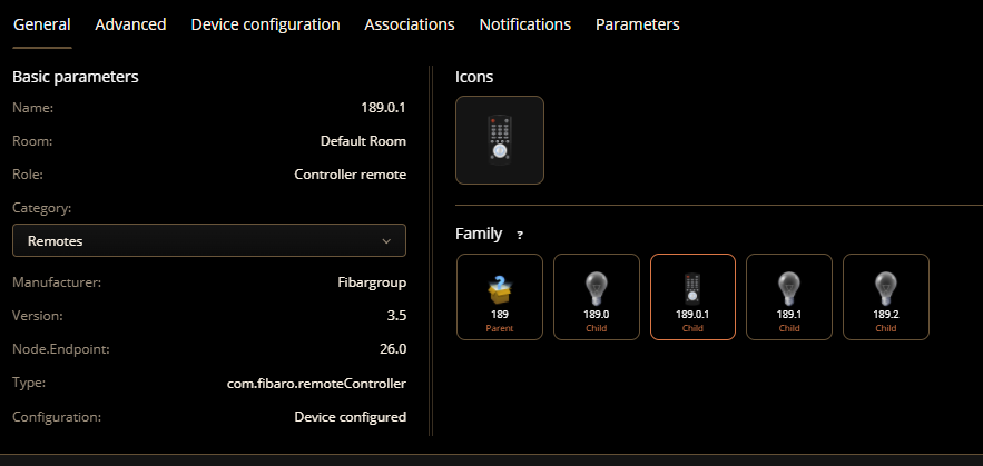

I have just added a fibaro dimmer 2 to my hc3 and it came up with this remote picture.
somehow it has come up as the wrong device and there seems to be no way to change it. I have repeatedly reset the device configuration but every time it comes up the wrong way.
Does anyone know how to fix the "Role" and "Device Type"
Everything is as it should be. The device 189.0.1 is OK. You can hide it if it bothers you.
Such child devices are not just created by dimmers. And you don't have to change anything here.
