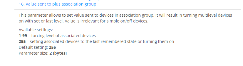

Hello Neo, thank you for message.
We have checked the described situation in our environment based on Walli Switch and Roller Shutter 3.
You have two ways to controll RS3 by other device:
  1. Add both devices to gateway and setup proper scene
  2. By the assotiations between e.g. Walli Switch and Roller Shutter 3
You've chosen second way, so you have to know it's important to properly set the values in parameters relating to assotiations.
So if you used Walli Switch 1st channel to controll other devices by assotiations you have to look into parameter no 156. Default value is 255 (0xFF). That means the command sended to RS3 will be "go to the last memorized position other than zero". So when your RS3 has position different than 0, the command will do nothing (because last memorized position other than zero is current position).
You can use values:
0 - to fully close
99- to fully open
1-98 - to set opening level different than 0 and 99
255 - to go to memorized position other than zero
The solution in that case would be to change Walli Switch parameters values as in table below.
Please try this configuration and let us know if it works as you want to.

    I tried to change the parameter 156 manually to value 99 you suggested..
    Nothing has changed. Everything is the same.

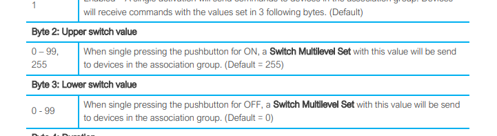

    the device need to have such parameter, if it doesn't you can just set something, parameters are unique for device/manufacturer/fw/hw version ...
    2 minutes ago, Neo Andersson said:
    Any hint what brand of remote controller can fully work with Fibaro?
    these i posted in my posting above, FIBARO: Walli Controller, Keyfob, Single/DoubleSwitch2, of course RollerShutter, Walli Switch and RS, Smart Implant, Swipe, even The Button can do it,
    From other i know (and not EOL) is Logic Home Matrix, afaik none of Sunricher, Heatit, Aeotec products.
    And there is one question spinning in my mind...Why is this set like this in Fibaro roller shutter module? What is the purpose ? Like i could undertsand if it was the case for all buttons, and all scenarios, but its not. The button press for DOWN movement works perfectly...Only the UP 1x. And the DOWN 1x press works from every position. It doesn't need ther shutter to be fully opened to get work..Really strange
    the motor/shutter have to be between 0 and 99% open (or closed, no matter, it is just % value of the position), the value set via assiociation must be therefore something between 0 and 99. And here is exactly the problem, most of remote controllers send 0 (down button / off) and 255 (up button / on). The 255 is what a e.g. lamp need, so everything ok with the implementation. However, the 255 is for RollerShutter "go to memorized position other than zero".
    Down works from any position, because it set value 0, which is always less than any other position (1-99%).
    Hold down is actually different thing, becaue the controller send "start" or "stop" level change when you hold it, and "stop level change" when you release it, so these are always valid values.
