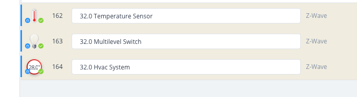

    Thanks. You mean uncheck "add with S2 Security if supported"?. Because I did it and...
    /monthly_2023_02/image.png.23f0dd4b74c8ebd41c946b6c0b59d071.png" />
    I obtained the same result:
