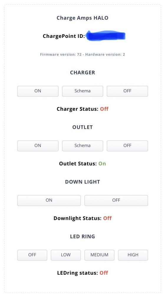

@jgab Spent some time on this over the weekend, managed to get a fully operational QA and then did an effort in trying to learn the method your code was built in and eventually managed to underst
