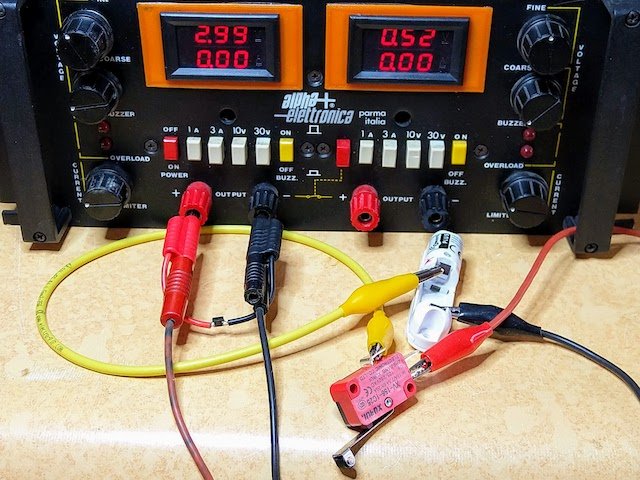

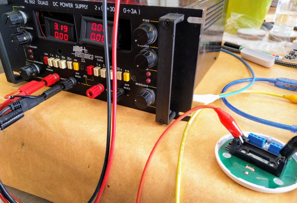

    I use a power supply to force a voltage, from high to low, while observing the reports in Zniffer and the JSON attribute on the HC2
    If I start at 3.6 V, power on and wait one minute, Zniffer shows the HC2 doing a "battery get" and the device responds with "battery report 0x64". The spec says this value goes from 0 to 100% and hex 64 is 100 in decimal, no surprises there. Spec also mentions, a device can report 0xFF = 255 to mean "battery empty". AFAIK gateways treat 255 like 0 meaning "empty".
    Then I do:
    print(api.get("/devices/24").properties.batteryLevel)
    And it says... 100
    No surprises there.
    If I drop to 3.3 V, Zniffer says 0x63 and HC2 has 99, makes total sense. Let's do a few more
    I conclude that the reports make sense, and HC2 faithfully reproduces them...
    Now don't quote me on this yet but based on reports from other users and my own observations (not measurements) I have always thought the batteries go from 30% to 0 really fast (days, maybe 2 weeks) and these measurements seem to confirm that.
    I am unsure, if this device is able to faithfully report levels below 30 % because I can see the signal getting weaker and some resends happen. That is one of those details to keep in mind.
    Tell me what you think...
