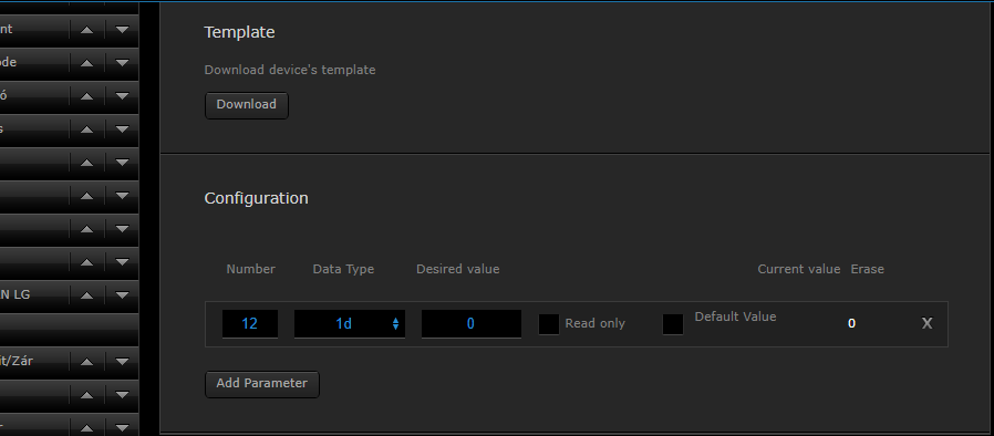

    Oh thank you!
    It worked until the "data type" had to be specified. I didn't know what to choose. But I will try what you wrote.
    There is also a "read only" and a "default value" checkbox. Should I check these or leave them blank?
    I was / would be curious about the parameters just to see if I could change something.
    Also, if there is a template, does the value of the operations change in the lua code. By this I mean that it writes a value of 0 for the open state of the shutter, as well as for the closed state. (I wrote it in a block scene and translated it) But, it executes the issued command in any case.

    Thank you very much for your help, it works as you described.
