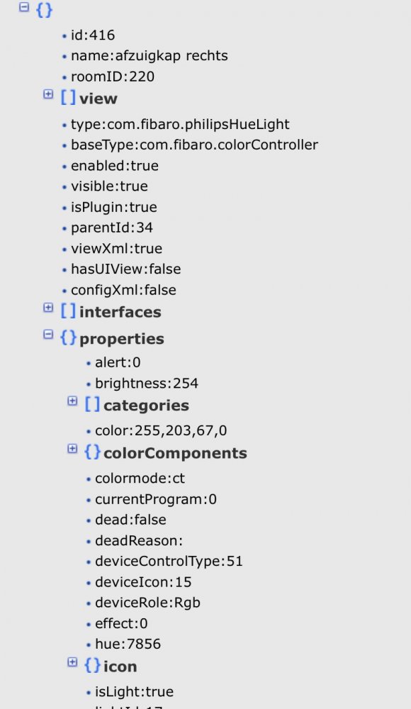

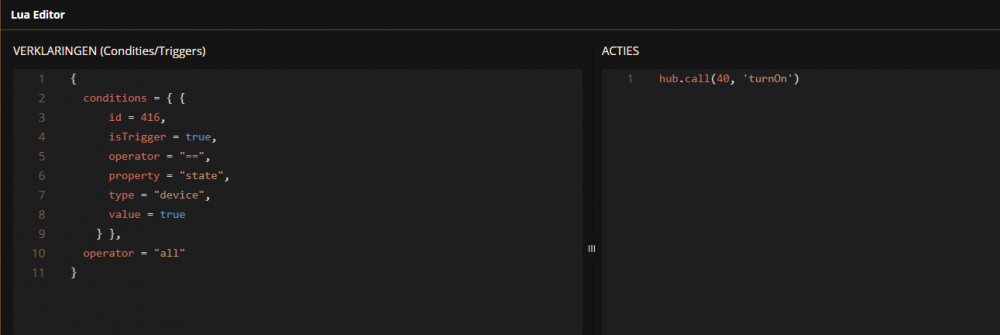

What I want to achieve:
When "kitchen lamp" turns on, the LED strip copies the status. So on or off AND the color state.
Below is the status output of the lamp i would like the led strip status to follow. (when turning on)
