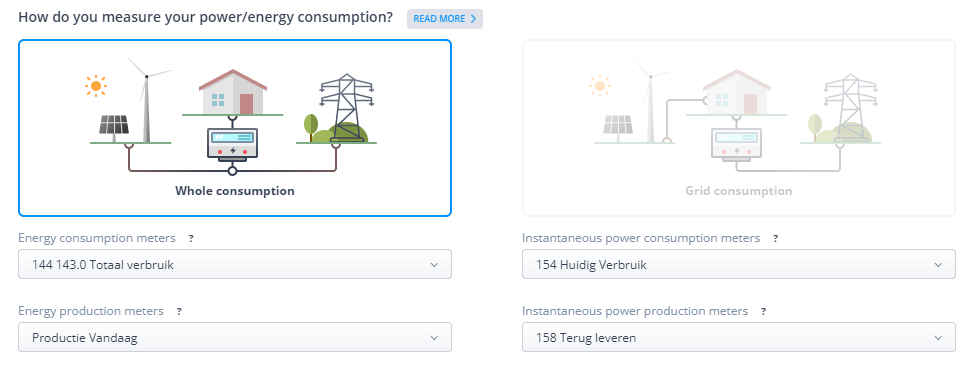

my Solar Edge quikapp works fine, the figures of the Solar Edge app and the Figures in my HC3 are spot on.
The produced Energy in the Energy panel is higher than the Produced Energy which is of coarse impossible.
for energy production meters, I selected Production today (Productie vandaag) in the meters configuration panel.
These figures should be equal or do I miss something?

Could there be any other device or QuickApp with rateType “production” with “Use stored energy data in Energy Panel” on?
The produced Energy in the Energy panel could be higher (and usually is) if you reset the meter. Keep in mind that resetting the meter doesn't clear/reset the counter in the Energy Panel.
For example, let's say it's 1:00pm and you produced 0.9kWh today. If you reset that meter, on the energy panel it will still display 0.9kWh but on the device/QA will show 0 (same in advanced ->Energy production). Same thing with consumption.
I might be wrong, but that's what I understood from the test I did last week. Perhaps someone from Fibaro could confirm/infirm or provide a better explanation for this.
