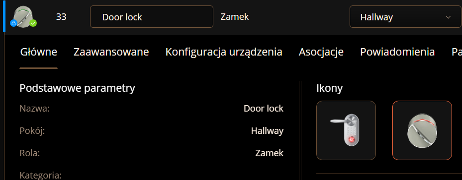

    I found:
    • Danalock is not possible to add in S0 mode
    • After new adding of Danalock there is endpoint 0 missing and is not possible to add it manually. In my experience endpoint 0 must be on every Z-Wave device. Without this no changes are sent to controller.
    This is Danalock device. No endpoint.
