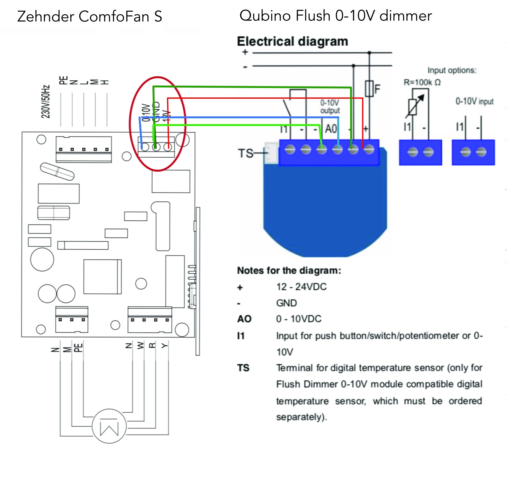

I also found a connection diagram.  And the quibino seems to work with the HC3
Next for me is to understand the diagram a bit more :)
xplj3NfZ77hBtxouR9sZalnH.jpg?f=user_larg
I Think again I am not  Electricien:
You need 10V for the dimmer and a resistance R=100kilo Ohm or is it together with the Quinino?
The wires in the red circle you need to connect on the connection just above your "BUVA"
than it should work? This connection is made for external operating?
Edited by Sjakie
I think
it takes the + and - (GND) from the buva (dark green and red) for powering the quibino
- GND (lightgreen) combines at the buva together with the 0 to 10v output from the qubino.
So, actually it is the same way connected as the image i posted before with the zigbee solution.
But now it takes the 12v from the buva, so there is no external adaptor needed.
I think this connection is there, for addons to the unit. Like moisture measurement and stuff.
So, this sort of works as a PWM controller, not sure what will happen when the speed is
set through RF. But maybe it will override as long as it is higher then the RF setting....uhmm
Complex stuff, maybe i just need to try it out :)
[edit] Orderd the quibino, lets see how this works out the coming week :)

On 11/13/2022 at 3:05 PM, Sjakie said:
hahaha, I don't think anything will happen.
Because on the print is a possibility for external operating, should work both I think.
Hey Sjakie, just to let you know. It works! And i'm still alive :)

Not really, the setting that i set with the remote. Makes it the maximum voltage what i can use with the dimmer switch.
So, when i set it to maximum with the remote i can use the slider in the homecenter. from 0 to 100% - thats perfect.
If i press setting 1 (slow) the voltage is low for the dimmer switch, and makes it useless.
But that doesnt matter at all, i will automate it all. And get some nice smart buttons for the toilets :)
Did i already thank you for your advice?  Thanks sjakie!
