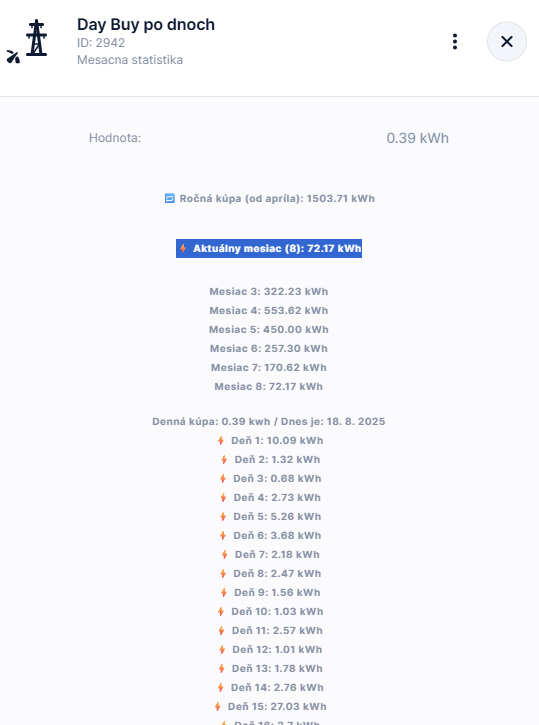

    I have it first experimenal. It is working  I have now some values.

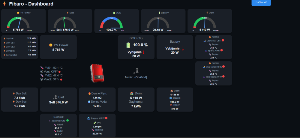

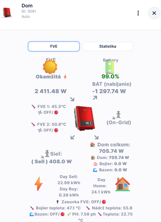

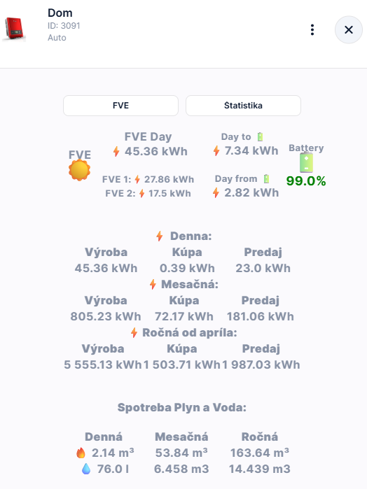

    sure. This is QA which I have now.  if somebody want here is my QA for Goodwe EM series and QA for ET series.
    /monthly_2023_01/snimka.jpg.fea808ead7f417229d88a302886dfead.jpg" />
    1. child - instant FVE produktion PV1 and PV2
    2. child - Battery
    3. child  instant home consumption
    4. child  instant pgridd from network
    5. child instant pgridd to network
    6.  child TodaysPVGeneration
    7. child Battery impoort
    8 child Day home consumption
    Edited by Martin555
    For ET I do it now. You have to wait. I have now this. If you want new with child send me message
    Edited by Martin555
