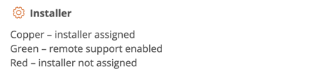

Here is what that red LED means from manual:
Red LED means that you do not have installer assigned. My HC3 is same and I must admit that this bothers me since RED always means something is not good, but in this case it is nothing bad.

    Hi @PedroChacon ,
    Just contact your installer and check with him(her) what is going on. It is possible that it changed to red after Fibaro servers went down.
