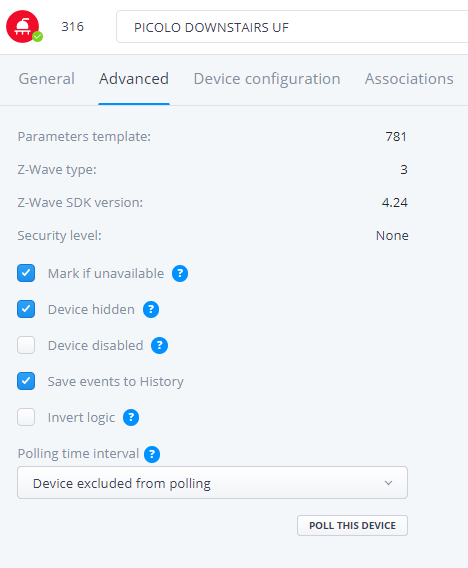

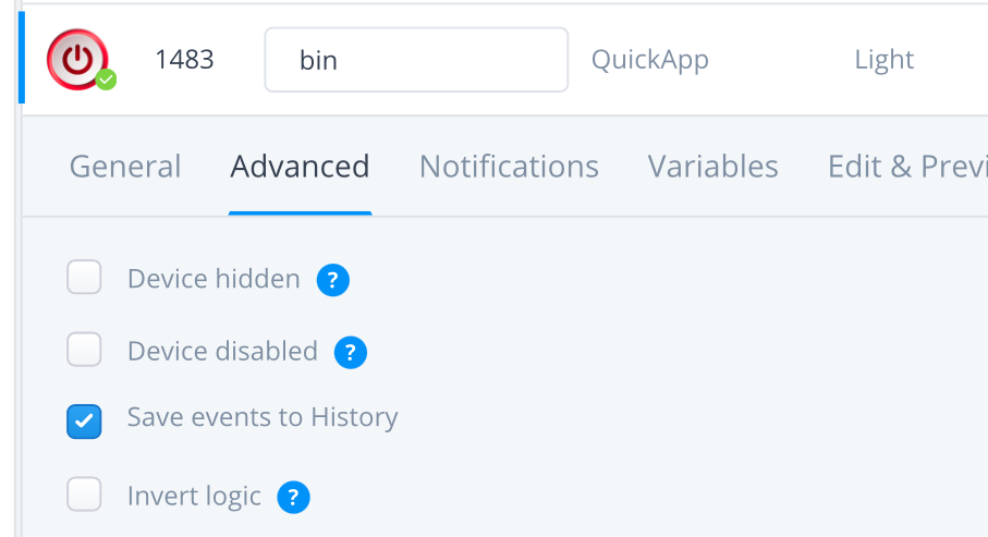

    Is save events to history enabled for the device?
    /monthly_2024_01/image.png.be07741efe5ac59f52fd63515376b7dd.png" />
    Yes, it should be. you show me the history...

    Yes, because there are only property 'energy' and 'power' in that period. No property 'value'
    So history is saved but not property 'value' (e.g. on/off)
    Link to comment
    I dont get it. How is it possible? You can see that i can see in Fibaros histry panel the enrtry for turnOn action
