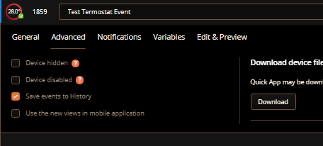

I got a Thermostat Heat QA that dosent show any of the custom stuff even if the Old view checked off:
the view i want in the app:
/monthly_2024_02/image.png.2b34b7549a181da6522ccc4922d1f07c.png" />
Settings:
View inn new app:
I am only getting the default heat profiles now, nothing of the temp readings and buttons 😅
Old app view:
Sorry, thermostats has full native support now in the app.
I will talk with the team if we can allow simply use the webView here.
