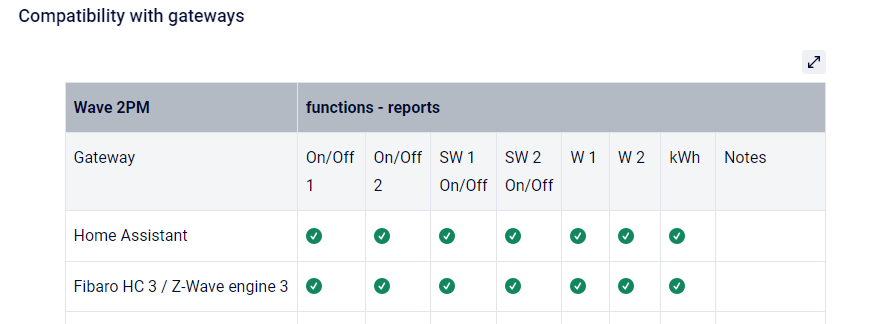

I can not add Sheely Quibino Wave 2 PM to Fibaro HC3Lite ?
I bought a wave2 pm module and I also have a hc3 lite, when I tried to add wave2 pm to the system I got no response from the system. What could be the problem?
11 answers to this question
It is only supported in the z-wave engine v3 :( And that is still in beta
@m.roszak May I ask why it isnt supported in engine 2?
I have always tought z-wave would work with z-wave, only thing would be the missing template 🤔
or is it because the 800 chip support z-wave Long Range too?
But then again the z-wave 800 chip should support standard z-wave mesh to🤔
I use this relay with Z-Wave engine 2, no problems.
If remember right, inclusion needed button click at first and after it button press with xxx(Check documentation) seconds holding.
I had to try multiple times to get it inclusion mode.

    In general, those devices are not officially supported—ZW3.0 is just much more advanced in terms of generic support; we did not make a template for it.
