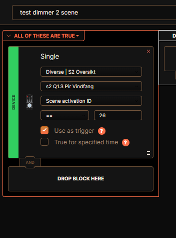

Like this :) (use the remote device on the dimmer2) this is for 1x click on s2 button
    Hi, yes that is exactly what I'm looking for. I don't have the option of choosing "Scene activation ID". Besides configuring parameter 28, any other dependencies in software or hardware (wire) configuration?

    the numbers that I marked is what you insert in the scene activation id (26) in the above picture :)

    The problem is that I don't have the Scene Activation Drop Down in the menu. Here is the screenshot of the configured device in the Scene building view.

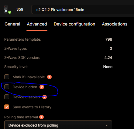

    aha check under devices and find the remote device on the fibaro dimmer 2. If your light is 360, the remote is usually ID 359 :) It might be hidden, so check the filter option.
    Hi, I did try that yesterday unhiding the device. However the device itself did not become available from the drop down list despite the fact that I've unhidden it. Then I at least know I was on right path. I'm not home right now, but I'll doble check in the afternoon and post a couple of screen shots if it is still missing from the list of available items in the drop down list of the room.

    Only one device for s1 and s2 the outpur id tells you if it is s1 or s2
    And remember to check if the remote device is in the same room as the light bulb when you unhide it 😄  This might be why you didnt find it yesterday :)
