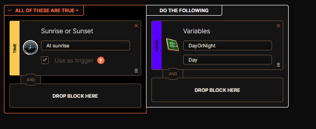

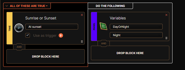

I've got a simple block scene for sunrise/sunset as a first go at trialling it to manage schedules on my new Hc3. I have my location and NTP time set correctly. Nothing clever as was suggested as a potential cause for issues
, just running at sunrise and sunset.
It's summer here in Australia, 17:30 currently. My scene just triggered. The sun won't set until 19:52 according to the Australian Bureau of Meteorology.
