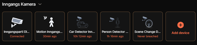

The myeye cameras from nice works good(got motion triggers on person,car, possible to flash the blue/red light or white light),
but if they wouldnt work nice then I would have lost my mind 😆
Also the picture works in both web view and app :D
(the motion trigger is a bit slow when detecting persons/cars, 2-10sec)

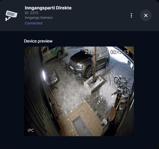

    But this still works:   (Only in app on local connection)
