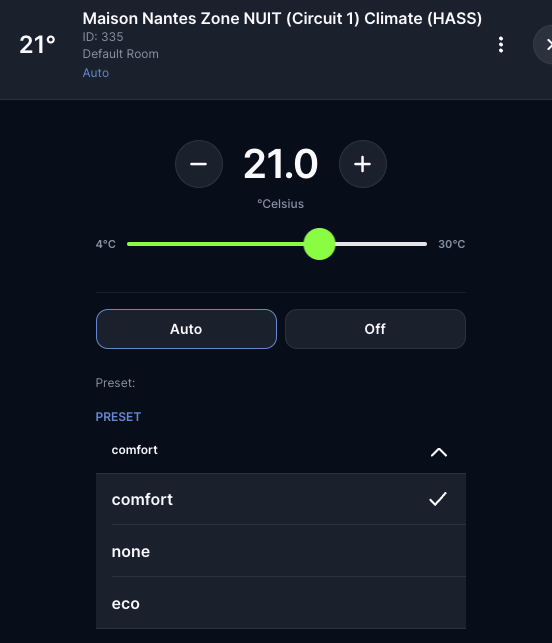

    i played with the QA but not able to add childs devices and especially i would like to control my heat pump
    entity is the following " climate"
    climate.maison_nantes_zone_etage_circuit_2_climate
    selected THERMOSTAT as class
    child device is create but it is empty.
    i m not sure to know how to solve this ?
    Result :
    Edit : I added not only 1 entity but 3 (climate + current +  desired temp)
    result  = Now i'm able to see thermostat mode (Comfort , Eco, Auto) but no impact on the HASS device
    /monthly_2025_01/Capturedecran2025-01-18a14_45_55.png.ee1816693d46ea31c823c316a7e73dde.png" />
    Edited by SakkhhoID

    Now it works  ! WOW =
    i'm able to manage change the preset mode. will continue to play with the QA

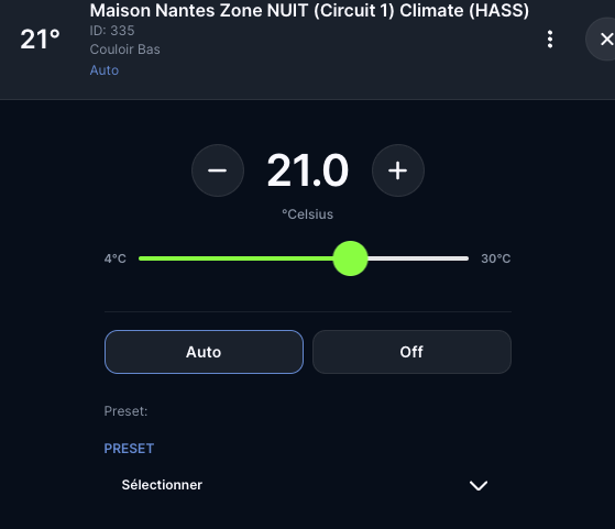

    if i'm moving the thermostat from the default room (where it is created) to a HC3 room , i'm lossing the preset mode
    /monthly_2025_01/Capturedecran2025-01-19a17_52_18.png.a02b8e3a5587307a0149a283af1ebe45.png" />
    nothing under 'SELECT '
    originally i have
    if i'm moving back the thermostart to DEFAULT room, still the same bug
    if i re-sync, same
    Edited by SakkhhoID
    3 minutes ago, SakkhhoID said:
    @jgab
    originally i have
    Shouldn't affect the presets. Could be a bug with the Fibaro drop down that shows up. Try to flip between some UI tabs or click on another QA and back to the Thermostat.
    Sometimes a reload of the web page does it...
    ok, the only thing to solve this is to restart the HC3 ...

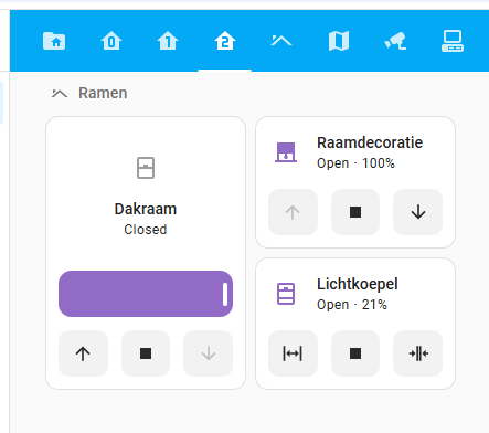

    To add cover (this is the HASS term, roller-shutter in fibaro) I see already jgab put in the 'Cover' class. I just enabled it by adding this in config:
    customerType:
      HASS.customTypes['^cover%.'] = function(e)
            if e.attributes.current_position and e.attributes.device_class=='awning' then return 'roller_awning'
            elseif e.attributes.current_position and e.attributes.device_class=='shutter' then return 'roller_shutter'
            elseif e.attributes.current_position and e.attributes.device_class=='window' then return 'roller_window' end
    Then by adding at the bottom evaluation:
        HASS.classes.Cover.auto={                   -- Define all door Cover types as Shutter
        'roller_awning',
        'roller_shutter',
        'roller_window'
    This worked out of the box. Integration back and forth from either HC3 or HASS do their magic.
    /monthly_2025_04/image.png.fb5f76342b56e15902eef0efa633df5a.png" />
