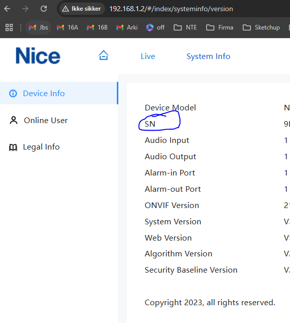

Then you go to the device/camera that is added and you need the IP, user and password and SN of the camera.
If you have logged on the ipadresse in the browser and configured the camera you can find SN number under device info.
