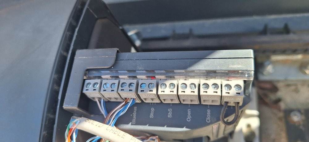

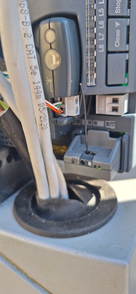

  1. Hi, I have a Nice controller which has been working fine for ~3 years. I bought a ibt4zwave module and I was able to open the gate using my mobile / voice commands. During these 3 years, the gate worked without optical sensors, so I asked a technician to install them .. It works fine, except the IBT4ZWAVE module stopped to work - I can't open the gate using my mobile device using Yubii Home application. I use Fibaro home controller for this. I want to check the hardware setup first. This is how I tried to reinitialize the module: 1. I have unplugged the controller from power (using circuit breaker) 2. Removed the module from the device 3. Switched on the circuite breaker Now I can see, the module green light flashes 9 times, than blue LED indicator flashes 2 times. It looks like Fibaro is able to communicate with the module. I have reinicialized the module: 1. Removed the module from UI 2. Added the module (pushed button 3 times) [14.03.2026] [12:13:45] [TRACE] [ZWAVE]: Home Center in learning mode [14.03.2026] [12:13:50] [TRACE] [ZWAVE]: Device added [14.03.2026] [12:13:50] [TRACE] [ZWAVE]: Requesting neighbours, please wait... [14.03.2026] [12:13:51] [TRACE] [ZWAVE]: Requesting neighbours done. [14.03.2026] [12:13:51] [TRACE] [ZWAVE]: Add node status protocol done [14.03.2026] [12:13:53] [TRACE] [ZWAVE]: Adding devices complete [14.03.2026] [12:13:57] [TRACE] [ZWAVE]: ID 217: Setting value 0 for parameter 30 [14.03.2026] [12:13:57] [TRACE] [ZWAVE]: ID 217: Setting value 100597760 for parameter 31 [14.03.2026] [12:13:57] [TRACE] [ZWAVE]: ID 217: Setting value 33488896 for parameter 32 [14.03.2026] [12:13:57] [TRACE] [ZWAVE]: ID 217: Setting value 50266112 for parameter 33 [14.03.2026] [12:13:57] [TRACE] [ZWAVE]: ID 217: Setting value 83820544 for parameter 34 [14.03.2026] [12:13:57] [TRACE] [ZWAVE]: ID 217: Received parameter 30 report, value = 0 [14.03.2026] [12:13:58] [TRACE] [ZWAVE]: ID 217: Received parameter 31 report, value = 100597760 [14.03.2026] [12:13:58] [TRACE] [ZWAVE]: ID 217: Received parameter 32 report, value = 33488896 [14.03.2026] [12:13:59] [TRACE] [ZWAVE]: ID 217: Received parameter 33 report, value = 50266112 [14.03.2026] [12:13:59] [TRACE] [ZWAVE]: ID 217: Received parameter 34 report, value = 83820544 [14.03.2026] [12:14:00] [TRACE] [ZWAVE]: ID 217: Received association report from group 1 [14.03.2026] [12:14:00] [TRACE] [ZWAVE]: ID 217: Received association report from group 1 [14.03.2026] [12:14:08] [TRACE] [ZWAVE]: ID 217: Device configuration finished I can see, the module in the UI, but when I send request to open the gate, I can see this error in the console: [ZWAVE]: ID 217: Application rejected request Not sure what's going on here .. When I try to read READ the configuration form the device, it looks like it's working .. Anyone has seen this before? Thank you, Juraj
