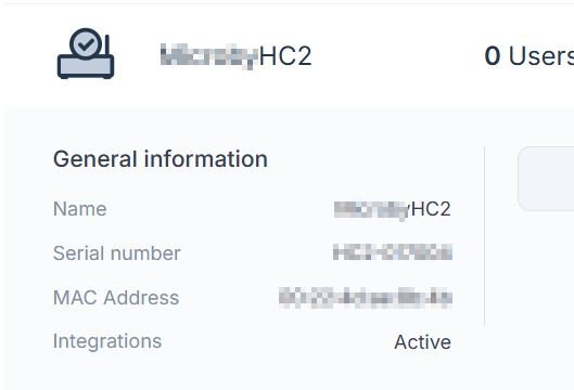

    and what happens if you activate the HC3 here?
    /monthly_2025_05/2025-05-0309_27_22-RemoteAccess_ManageYourHomeFromAnywhereOnEarthund5weitereSeiten-P.jpg.17c2783ab169d48c7780d13dbf3a3252.jpg" />
    My old HC2 is activated here.
    2025-05-0309_31_30-RemoteAccess_ManageYourHomeFromAnywhereOnEarthund5weitereSeiten-P.jpg.cd7d9f016b0f525357ea3a013a9f7eaf.jpg
    That button "Activate" should actually say "Set as default" ;-)
    It is a button to enable voice assistants ;)
