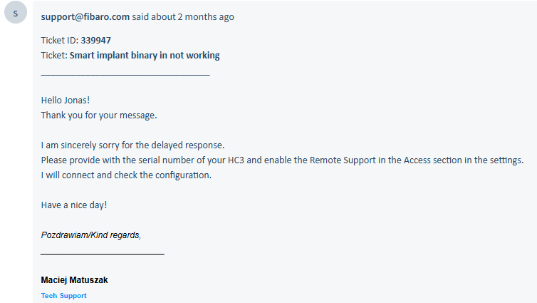

    My ticket is: "no history #339040"
    I also have another ticket issued Jan 8th in another matter also no response:
    "Smart implant binary in not working #339947"
    all silent since 2 months now... on both tickets. Got a response after sharing ticket id's but then nothing more...
    /monthly_2025_07/image.png.49b174e196c1bc76b21c05872e200304.png" />
