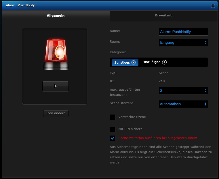

The scene is on "automated" with a trigger "other".
The checkbox to continue to execute the scene during alarms is activated, too.

    Scene is on automatic
    Long ago I used HC2 but should there be  in properties:
    %% autostart?
    Here is header of my scene that was working in the past and I didn't change its code after I deactivated it in alarm panel:
    So, no autostart, no included global variables or devices to trigger the scene. It should be triggered only by alarm panel.
    Rest of the setting on your scene are same as on mine:
    So I suggest that you remove global Zentral from header and do not check it as source trigger, but when scene is started by alarm panel just do the action of sending notification.
