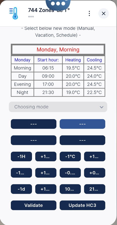

    Using it I have been able to create a QA which using a single UI view enabling any change of any climate zone parameters.
    Will be easy to add a child in charge of managing Thermostats with your own way.
    For your information, the QA UI looks like that in YUBII:

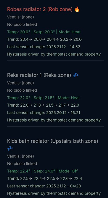

    We have never ever used the Heat Activator plugin. We have our own developed, very dynamic, flexible plugin for that. It not only manages boiler->thermostat relations but also heat pumps if there are any. It also monitors ventils (if any) linked to a thermostat, and monitors the temperature trend (user can see actually how the tmperature changed over the time) and most imprtantly user can see if the zone is actually heating or not. (using heatRequired property from fibaro heads, and other known properties from other brands, and if theres no such property it falls back to temperatue+hysteresis vs setpoint logic).
    So that part is working like a charm for us. The only part that is not reliably working is the sync between the modes. It is obious, that putting the schedule into OFF mode might, or should not mean, to set OFF the thermostats. That i can understand. Because setting a schedule to OFF should mean, that fibaro takes aways its hands from setting any setpoints on thermostats. However, if user has thermostats included on climate zones, so he has some schedules running, there can be some moments, when he wants entirely turn off the heating, so set all the thermostats to OFF mode. In this case setting the zone to OFF doesnt help. The only way to achieve this is to set zones to manual-> permanent OFF..Thats the only way. However, calling this on 15 zones manytimes ends in failures on some zones. Some of them remains in HEAT, some of them gets to OFF. So we decided to call these manual OFF commands with some delays. We will test this approach , but it seems that this solves the puzzle.
    /monthly_2025_12/image.png.5d9f0211d590a4bd2bff8c52397bb779.png" />
