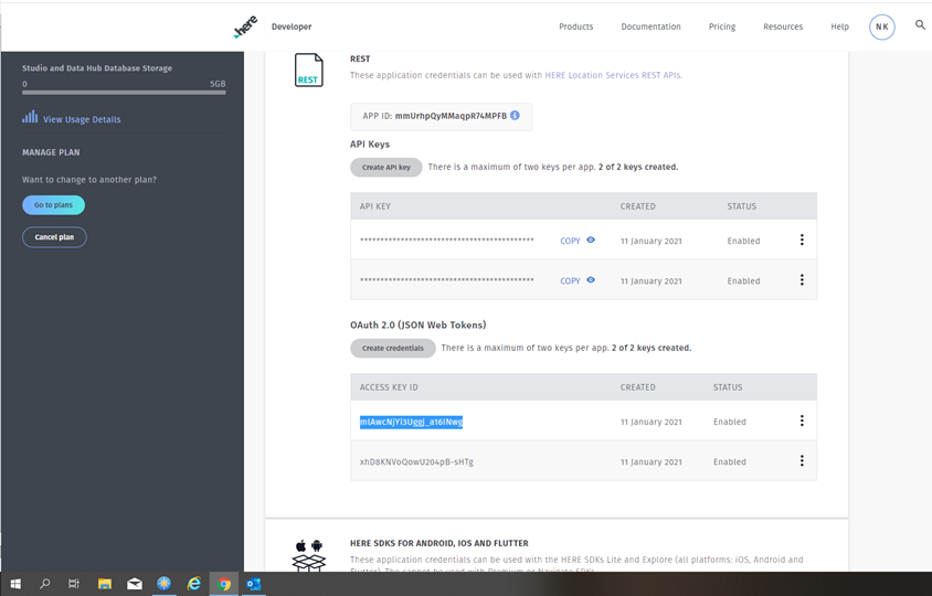

unfortunately I can't enter the codes, I'll try any of them. there will be three separate codes compared to the guide. javascript, rest and OAuth 2.0 (JSON Web Tokens). Each gives you an access and a code.
nor do the icons appear. true, I'm sure I'm thinking very badly of sg, because so far no icon has appeared that I've uploaded. i don't understand what i don't pay so much attention to:

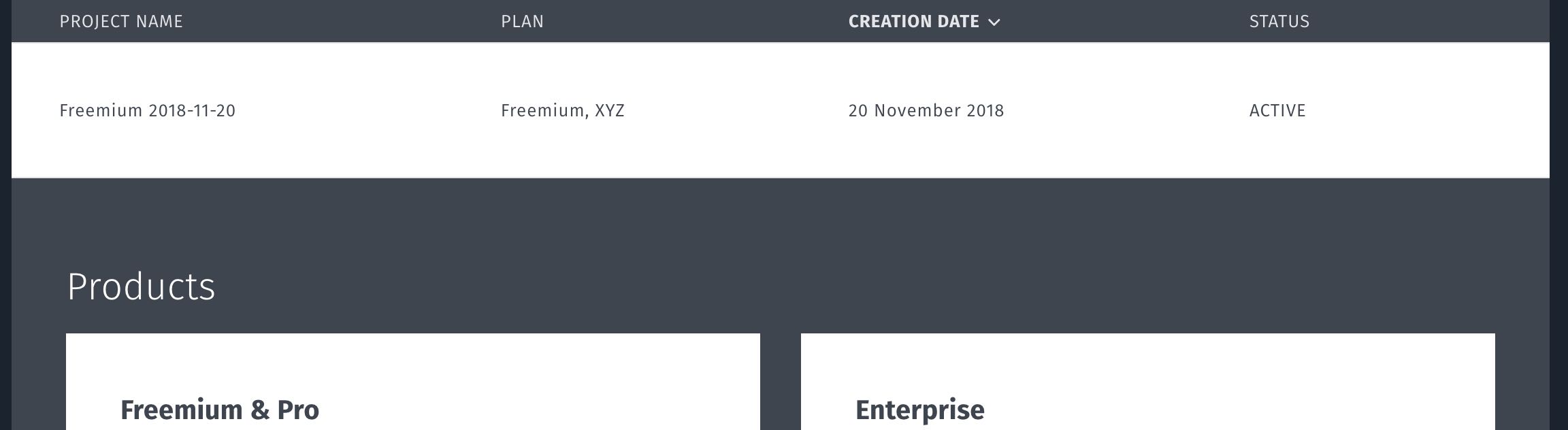

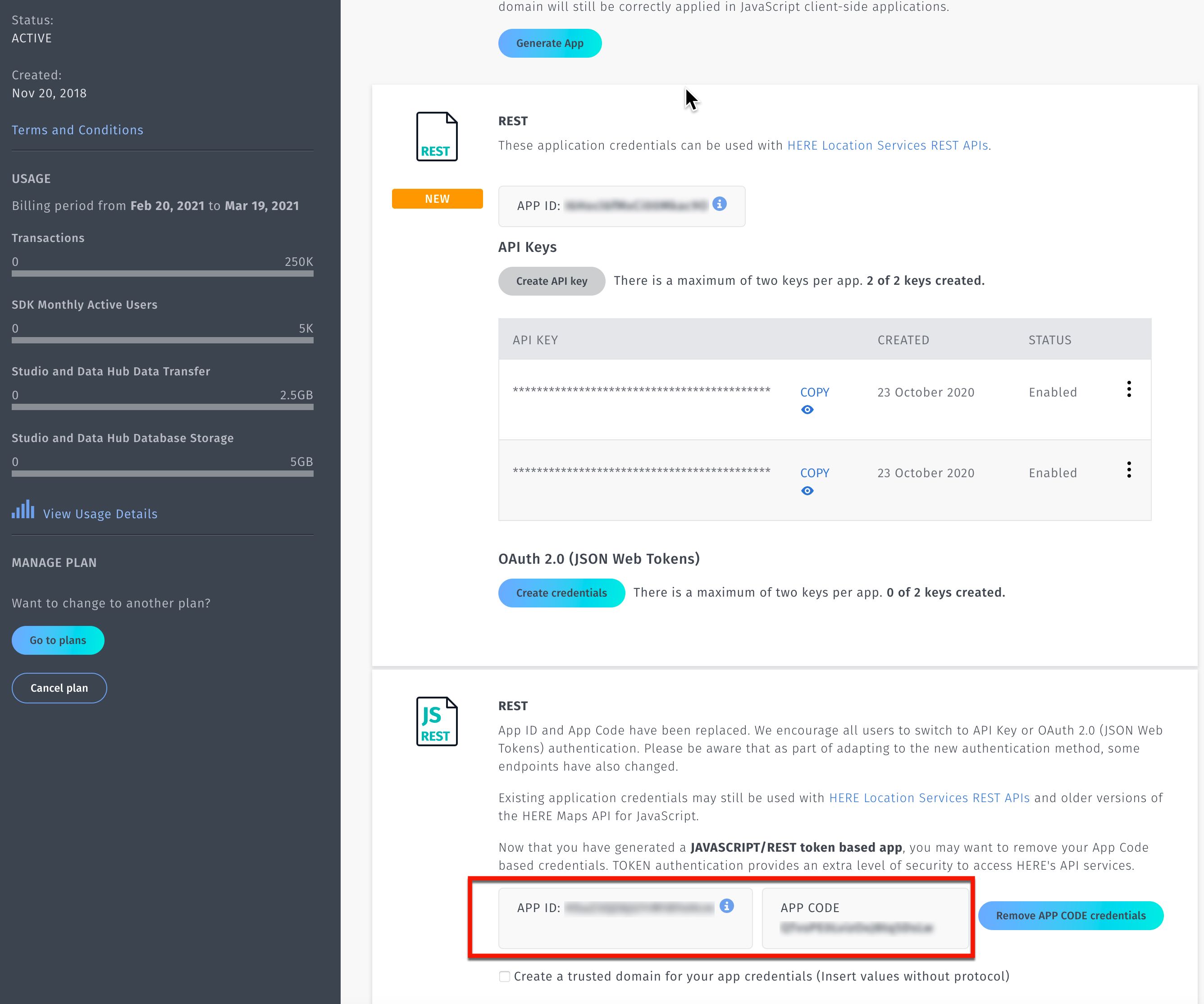

Regarding HERE location services app ID and app Code, just login to your HERE account and first you will be presented with your projects:
Spoiler
Now click on your project name and you will be presented with your project data:
Spoiler
For Advanced Radiation Monitor you need to use APP ID and APP CODE that is marked with red rectangle on above picture.

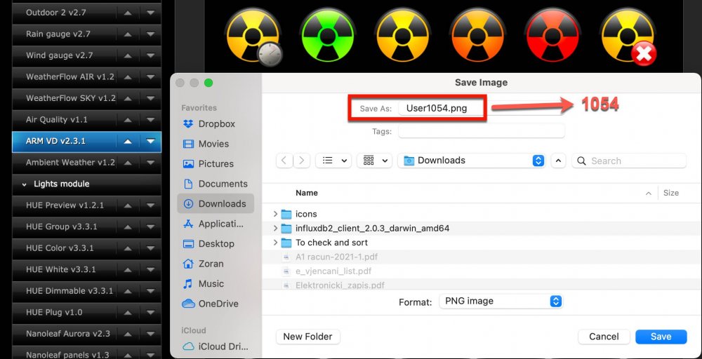

After you uploaded icons you need to find out their ID number. To do that you need to edit VD and click on main icon Change Icon button. Window will open with all imported icons. In Firefox just RIGHT click on icon and in drop menu select 'Save Image As...'. Browser will open window to save icon and there will be complete name of the icon. In name there is a number which you need to enter in ARM VD main loop:
Spoiler
Hope this helps!

kopek
hello Sankotronic,
grateful thanks for the help!
Unfortunately for me, that bottom looks different.

hello Sankotronic,
or, I'm not using Firefox .... although I don't know if that could be the problem, because for some reason, unfortunately, I haven't been able to add a single icon anywhere.
the size is good, the extension is good, and does not appear, only a small square in the large square ...
