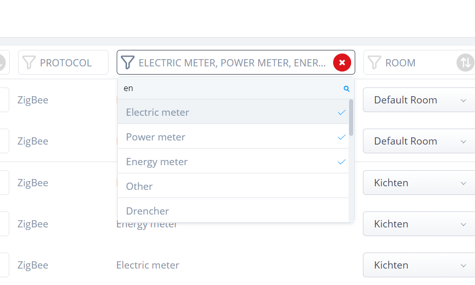

Guest Jasper Waale
This is wonderful and I simply do not understand why the HC3 has so bad energy reporting to start with and ok some " solar" but face it most of them have no use for that and like
function like this to track the use, the green " bug"  must have hit hard in Fibaro home offices making so much energy stuff that nobody in fact is able to use
BUT this is what we need, the ability to track use, pr device and for a full setup,  I might be outside bell-curve as just finished putting in energy meters on most things that use power
washing machines, water pumps, aircon etc.
Im trying to modify your script,  I'm not a coder, so for now, I do not get emails but Im struggling with the automatic part, ( I want to try to avoid the manual that works fine as I have so many devices )   I see as I have miz of brands and also some ( don't tell anybody ) Zigbee
that " power" misses a few things, so I was thinking that the below might work but still only process the first line.  if look under the device in HC3 and use
   pwrIDs = fibaro.getDevicesID({interfaces = {"power"} or {"energy"} or {"electricity"}, visible = true, enabled = true})
Wonder if you are able to point me in the right direction.
jwi
@Jasper Waale , I hope you know that ZigBee is still in beta at fibaro, so there may be problems.
At the time I coded this script, fibaro didn't have zigbee yet. But let's see, maybe there is a solution.
As far as I know, a property of the device must be "power". But you can also try “light”. The "ROLE" is only for filtering and you can set it for each device in the "General" tab.
I have 3 different ZigBee devices and all 3 are addressed with "power". But you can also combine a combination of manual and automatically found IDs.
For that paste this code at this point:
if manually then
   -- Manual entry of device IDs for evaluation.
   pwrIDs = {213,224,256,264,285,305,322,339,383,391}
else
   -- Automatic determination of electricity consumers.
   pwrIDs = fibaro.getDevicesID({interfaces = {"power"}, visible = true, enabled = true})
-------------insert -------------
mpwrIDs = {999,1201, }   -- enter manualy your IDs
for _,v in ipairs(mpwrIDs) do -- this code joins both tables
    table.insert(pwrIDs, v)   --
Good luck
