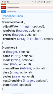

Hi @amurray85,
Just try this code it should work:
You don't need to put complete table when it is sufficient to just change rainDelay in your case. You need to refresh sprinkler panel to see result!

11 minutes ago, Sankotronic said:
Hi @amurray85,
@Sankotronic you're the man... thanks to everyone for helping out..
Love some short and sweet code which is to the point. The above worked a treat. I even used it to adjust the AdjustWater function.
