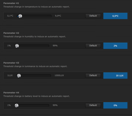

I have a 14 of these multi sensors around my house and I am trying to configure them as best as I can.
All of my devices are USB powered and were included under usb power. All are running 1.7 fw
I am also trying to rule out these devices as a potential root cause for what looks like busy zwave traffic / slow responses.
I looked at the parameters and there would seem to be options that can be tweaked. For example i can switch off reporting for UV as all my devices are internal.
I was wondering has any user changed specific parameters, why they changed them and what was the impact/benefit.
