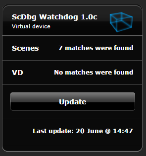

The VD has a status label and when it was last run
 watch.PNG.3ba1125c1bf4c5cba0c2c5b4aa2036df.PNGwatch1.PNG.b31653c26fea066e89d95fea10dbf911.PNGwatch2.PNG.07ad9270adbd029e6bfb9fb4d6a46d4e.PNG

    very slight change (1.0b)  to show it running as it is checking the scenes in the status label
    /monthly_2017_06/watch.PNG.731914d0542fa7a8c731a98dfba69ba9.PNG" alt="watch.PNG.731914d0542fa7a8c731a98dfba69ba9.PNG" />
