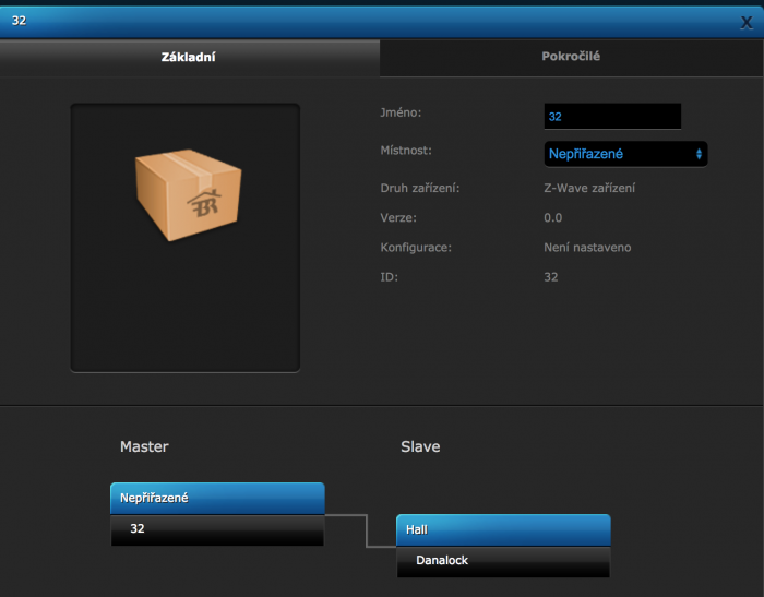

Im having problem with Danalock v3 not reporting back to Fibaro that its unlocked/locked when locking with Danalock app or is it me misunderstand function? Do i have to add a parameter to get real status of the doorlock?
Edited by Teddan
I also see that the communication between the lock and Figaro seems slow and unreliable.
I was assuming it was related to missing possibility to set poll timing.
I would like the lock to push message z-wave to Fibaro when operated by app or manually.
Exactly what i want to do, found this Danalock parameter guide and locking with bluetooth or z-wave is same notification.
From The beginning my lock show If i used a key or The danalock app like this. But no more  :(
I asken Dana about it and they tell me its in my hc:2.
From The beginning i installed The lock wrong and The hc:2 shows manually locked. Correct installed an no manually info....

Customer discovered that he has problem with devices visibility, while Danalock is in FIbaro system.
Can you see history of changing states of Danalock and other devices in Event panel, while you have Danalock in system?
I can see a lot of events, but no Lock/Danalock events at all
Just checked, and the lock is supposed to log events, strange..
