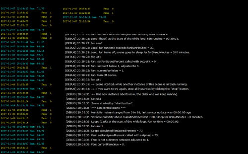

The log output looks similar to this:
Since I took that screenshot I decided it was nicer to reverse the order. If you look at the script you'll see that's only a matter of changing > to <

    This is the first log:
    /monthly_2017_11/pic-time-A.png.f7b8f8852dbe011127b07bce68352d1d.png" />
    Commented:
    at 23:16 the humidity is below MIN, no scene is running
    at 23:18 the humidity is above MAX, the scene is triggered and fan ON
    at 23:22 the humidity comes below MIN, the shuts the fan OFF and the scene ends
    OK, no problems so far.
    Let's look closely to what happens next.
    at 23:24 another shower raises the humidity above MAX and the scene is triggered again, fan ON
    23:27 the humidity rises well above MAX
    23:33  the humidity gets lower but is still above MAX
    Let's see in the next log what happens next.
    23:35  the humidity gets lower but is still above MAX
    23:35  the humidity gets lower but is still above MIN but below MAX
    23:41  AFTER THE FAN RUNMINUTES period the scene enters the FANSLEEPMINUTES period
    But back to the bathroom (see log above:)
    at 23:43 another person enters the bathroom and takes a shower, the humidity rises well above MAX, but the FAN stays off
    23:54,  00:50 The fan doesn't respond to manual interference to get the fan on (of cause a scene activation killing the running scene could be a work-around
    01:30 even 2 hours later the humidity is above MAX and even above 90%:
    The humidity stays high for the next hours, but as the FAN is OFF the humidity starts to spread to the adjacent room:

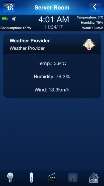

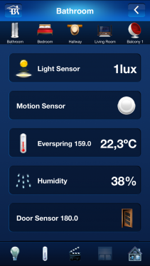

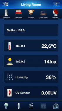

    Hi to you all.
    I have struggled with this problem for few months... the major problem that you have fixed Min and Max limits.
    In reality the humidity changes all the time, even during the day and I don't mentioning during the seasons. Based on my experience this is the REASON that FAN in many cases couldn't reach MIN limit  or doesn't starts properly.
    In order to create dynamic limits I have found that additional sensor is required. The sensor could be motion or light, in my case I'm using Aeon Lab humidity, motion and light sensor. Three sensors in one package, best solution and could be connected directly to power (w/o batteries).
    After adding these sensors  the scene runs excellent for last two years w/o FANSLEEP or any other timeouts.  The fan triggered immediately if the humidity increased by 2% and not only when humidity reaches MAX limit, so  it keeps humidity level very low at  bathroom constantly. I don't have steam/fog on my mirror and the walls  and ceiling are clean.
    Please consider to add sensors....
